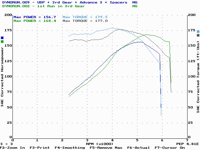

I think the gist is that the 12v setup puts down more torque earlier in the rpm band... but after about 4600 rpms, the 24v setup clearly has the edge. The plot below pretty much says it all. (this is SOHC-12 vs SOHC-24)

Some more aggressive cams and shortening the spacers would probably help the high-rpm hp... Before the spacers, the hp peak was higher in the RPM band.
I think to make higher RPM truely effective, the fuel curve needs changed...
