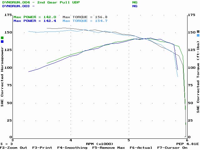

A couple years ago I dyno tested the UDP and found that it does not add peak hp, but does add ~4 off-peak whp. If you search the 3L section of the Forum, I am sure you can find all the results.

BUT... I was with Ed when he did the UDP vs no UDP test. As he commented, there were marginal off peak gains and the peaks were the same.

Here's Ed's van with and without an underdrive pulley. Green is with. Blue is without.
