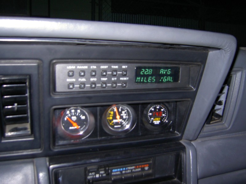

You need one of these...
tryingbe is offline

What was the first picture?

Ah, I have had those before. They are easy to fool. Just build up some speed at the top of a hill and slip it into neutral. You can coast for a mile or two and really jack up the fuel economy reading. Do that after you hit the reset button and it makes your tank average look good. When you do your actual calculation when putting gas in the car, your mileage is only slightly improved. I've done it since these travel computers came out in '84. Sometimes, I'll catch a salesman doing it to a used car for the sake of the customer's concern over the car they are purchasing for fuel economy.
The best way to measure fuel economy is to pump the gas yourself from the same pump on the same day. Divide miles driven by gallons pumped. The most acurate method was to put a one gallon bottle of gas in the fuel line, switch it on, drive it til it dies. That is tougher to do with the fuel systems we have now.
Besides, where would I fit that into the Shadow dash? I don't recall them being offered on the P Bodies.

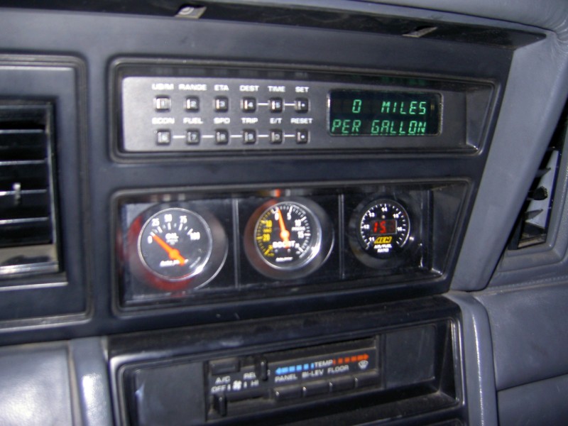

Got the pic to work
As for the code 26, I'm with the above post. The connector at the injector and the connector by the head both seem to cause issues. The grease that's in them is OLD and dirty, so get some electical parts cleaner and new dielectric grease. Clean the plugs and such(if you can actually clean each contact it will be even better), put the dielectric on them, and let 'er rip!
