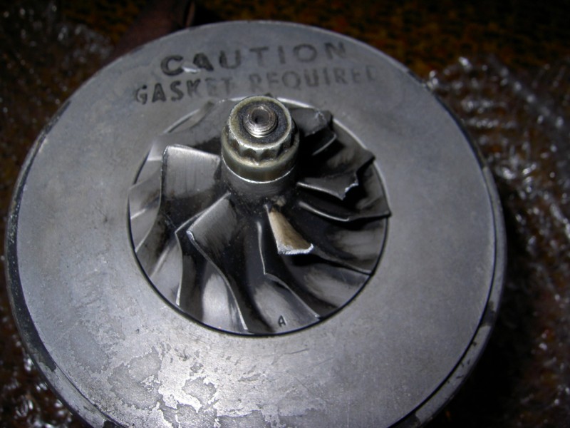

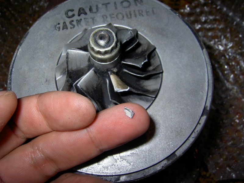

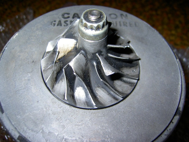

Most likely foreign object did that damage to the wheel.
Here's a trashed turbo I got because the person doesn't know what it means to PACK.

the sock was being used as an impromptu air filter while I was rigging up piping. had to go to the parts store to get... hoses I think. had the sock over the intake of that hard ribbed rubber hose that comes off the intake of the turbo, and apparently both my sock was too stretchy and the turbo was too hungry for souls. (and decided sock also started with an "S" so it would do) All the sock got stuffed into the intercooler so nothing went in the engine. Heh, it looked like a uhaul furniture pad, only finely ground sock instead of blue jeans.
(in the first pic, most of the blades of my turbo look like the bottom left blade of that turbo)
