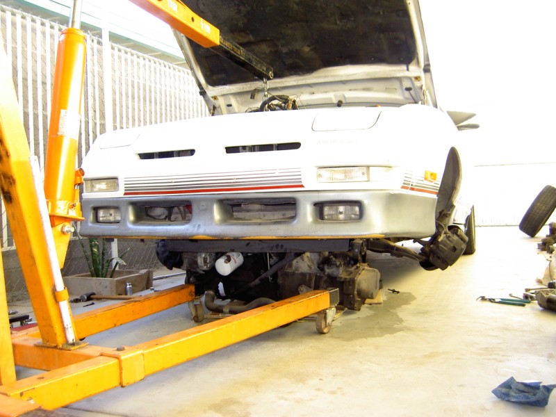

Dropped the engine with transmission, didn't even need the hood removed.
