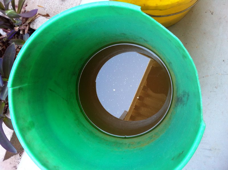

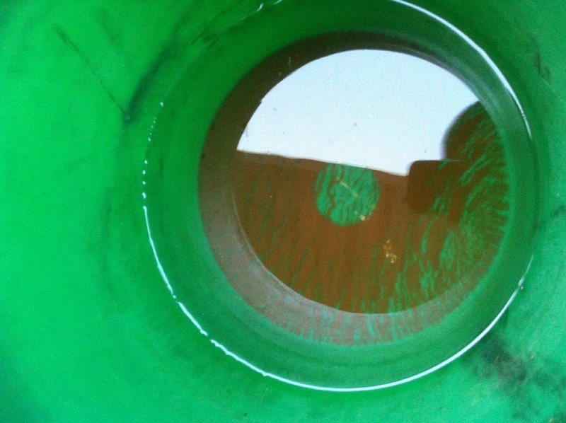

Stop leak will clogged your radiator and clogged your heater core. It'll cost you more money than you think you can save.
One of the worst product sold for automotive use.
This is after 6 flushes, damn stop leak is still there.
