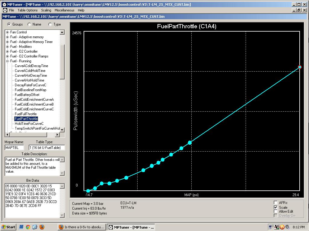

I took the T_LM_22_MTX_A171_Stock file from ShelGames' site, did some tweaking to my liking and I am not able to get it to give the car enough fuel at part throttle while over 5 PSI. wide open throttle I have it set just right around 11.5 at full boost. and from 5 PSI up I have the part throttle table close to the WOT table but once I hit over 5 PSI it starts going leaner and leaner it has gone as lean as 14.1 on the WB but as soon as I floor it the A/F is down to 11.5 range. is there something I forgot to change in the Cal? I really don't want to start from scratch because I just got it where I like it besides the lean at part throttle.

I'm giving it just as much as the wide open throttle table at 5 psi and above but it doesn't do anything.

There is no point going any more because it only gives fuel to the max of the wide open throttle table.

At part throttle, it will always stay in closed loop control and try to get to 14.7. There is a boost limit to closed loop, though. Look for "MAPLIM_NoCellUpdateAboveThisMAP" in the Fuel\O2_Feedback_Control\Adaptive_memory\ group. Stock, it's set to 1.2psi. Anything above that, it should go to open-loop and the fuel tables will set the A/F.
Thanks I will look for that later today, it doesn't ping or anything when at part throttle and lean like that but I don't want to take any chances.
