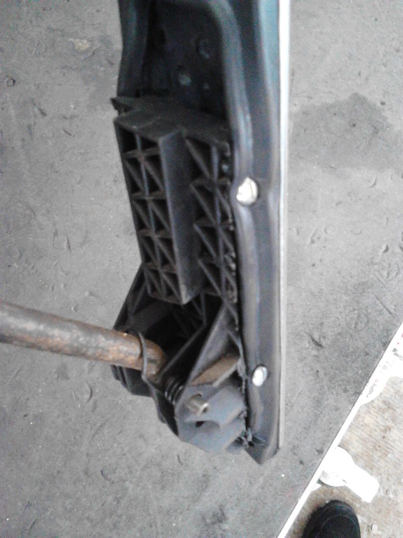

And, I finished up the "A" pillar dual gauge pod fab as well.
It's basically 2 generic "A" pillar gauge pods mounted to the "A" pillar trim and,
molded into the trim with plastic weld and epoxy.
Then painted with Textured spray cans.
First, I attached the pods to the pillar trim with screws.
Then cut or grinded the heads off of them(Note this actually melted the plastic of the trim around the bolt)
Not a bad thing. Now the blots are perfectly formed to the plastic(or the plastic is formed to them)lol
I also cut off the end of the screws on the inside of the trim.
Now they're just reinforcement "beams" if you will.
Here's some of the early pics from when I began.
I lost a whole bunch of pics I had but, you'll see how I marked under the pods to cut:
And, here's a few early pics after the first shot of plastic weld went on.
I screwed through it after it dried to prevent flexing.
Drilled a hole in the pod for the factory trim screw into the "A" pillar ^
This was a LONG, DRAWN-OUT process that took me FOREVER.
The main reason is that the Plastic weld or epoxy must dry completely before it can be sanded.
So, here's some pics of the process:
I would apply the epoxy, allow it to dry then primer the part.
When the primer dried, I would sand where necessary and,
apply more epoxy:
This process went on endlessly.
I wanted it to look like it came this way!
Finally, when it was done to my satisfaction, I began painting it dark gray with
textured paint from Rust-oleum:
And, here's what I ended up with:
Hope that covers it well enough.

Recently I was bored and, knew there was SOMETHING I could do;
So, I got to modifying the GLHS accelerator pedal and combining it with the ULTRA-COOL(IMHO) SRT-4 pedal.
Here's the result of that:
Got the SRT-4 pedal cover for $8 at neons.org and, modified the GLHS pedal to accept it.
Not all that difficult. The hardest part was "thinning down" the GLHS pedal.
Narrowing it was a snap but, thinning it down was kind of tricky.
The screws in the side are to ensure it doesn't come off when MASHED TOO THE BOARDS!
Thanks for checking it out.
