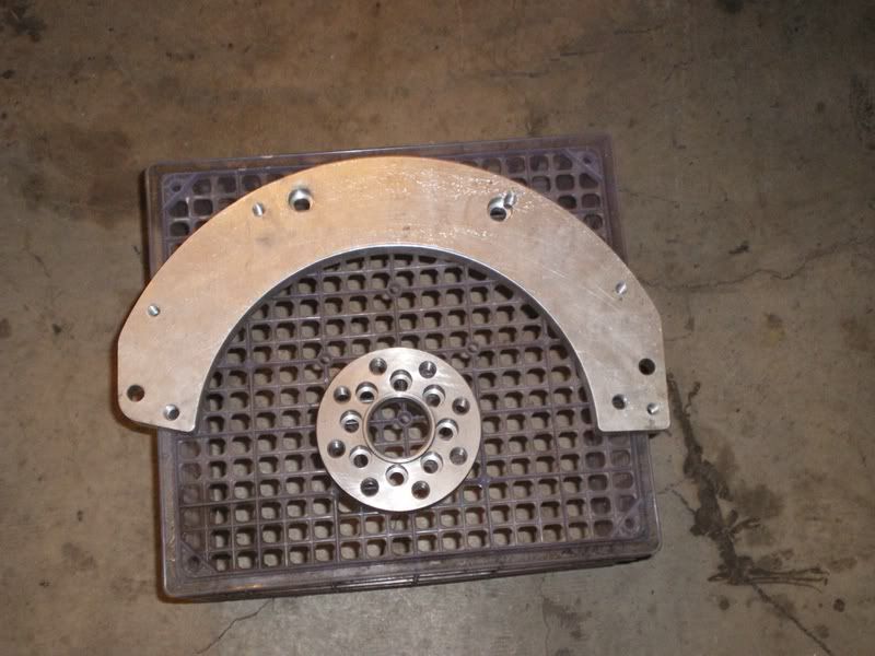

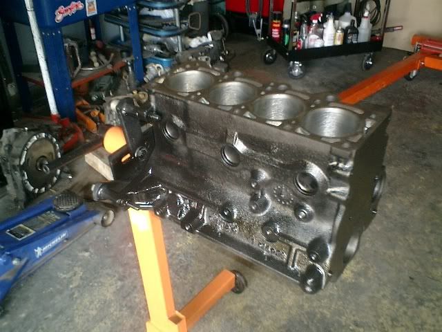

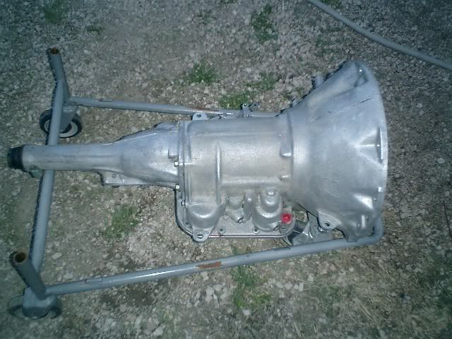

2.5 CB out of a 91 Dakota,88 Turbo Head, A904 3 speed Torqueflite, Glenn Smith tranny/engine adaptor(thanks turbodave/neon)

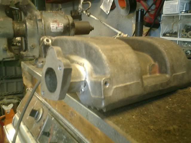

No idea on what turbo or EMS am using , Am planning on building my own custom intake and exhaust manifold for the FWD configuration, here are some pictures............Andres.

I would do a 2 piece lower half and a 4" plenum. Or do you want a lower RPM big torque and massive boost engine?
Hello :D
Good sugestion,:confused: that's what a friend recommended,:bang head am looking for a lower intake so I can ad the top plenum.
I just put this intake together so I can preplan the routing and placement for the intercooler.

Make sure to throw away that 1 piece you have in that picture after you get your routing and tests sorted out. :p
Hello Ondonti :D,
So you dont think this intake will get me going for the mean time:eek:.
It give me some pracitice time working of cast aluminum, first time welding on this kind of material, so pourus it holds alot of dirt, oil. I read ,I have to burn the oil with a torch then clean it with some kind of acid before welding.
Usually I just I just wire brush it and wipe with acetone and am good!

one the intake, as scary as it is looking it'll work a lot better than the stock one. Buy a 2 piece and a 4" plenum and have the welder reverse the end plates lol. With the weight you don't want it to build torque without HP like a cummins. You can also hack the guts out of the intake from the back side and weld a big plate on it turning the 1 piece into a plenum if your good at welding aluminum.
The intake is calling out to me that it wants you to cut it up and do as similar above if you dont get a 2 piece. ;)
Got it guys!!:eek:
Any good pictures of what is should look like, This is my first time welding cast aluminum, I need to practice with it..........................
Andres

looks like jb weld is going to be your friend on this. :p
Even experienced welders don't like the idea of welding old dirty cast aluminum.

are you using a tig for the cast aluminum?
Yes, tig:)
C'om man!!:eek: the part am welding is wire brushed and acetone wiped, I read I have to put the torch heat it up to burn all the junk on the porous(spell).
I tig stock aluminum before, not cast!!
