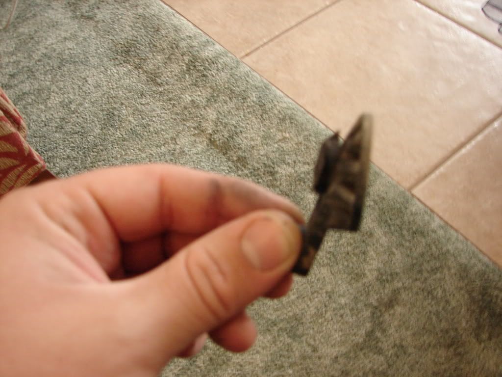

so I was changing the oil. happend to notice the clutch cable didnt look exactly right. course its not, the cute little plastic spacer between the cable end and tranny is crooked and mangled. and its been like this for some time... as there was very definate and disturbing looking wear mark forming on the transmission case.
p/n 4641289 discontinued and unavailable from "c"
dealer search showed 2 dealers who might have any left in inventory
right now I will be looking for a good donor. but really need a new one. would anything from a neon remotely work or is this gonna be a fab job

A neon won't work at all, completely different clutch cable setup. Nothing at your junkyard? Pretty sure any and all eek manual transmission will have that piece.

There are no manual transmission eeks at any of the local yards :( . I will probably get a block of hard plastic and make one.
