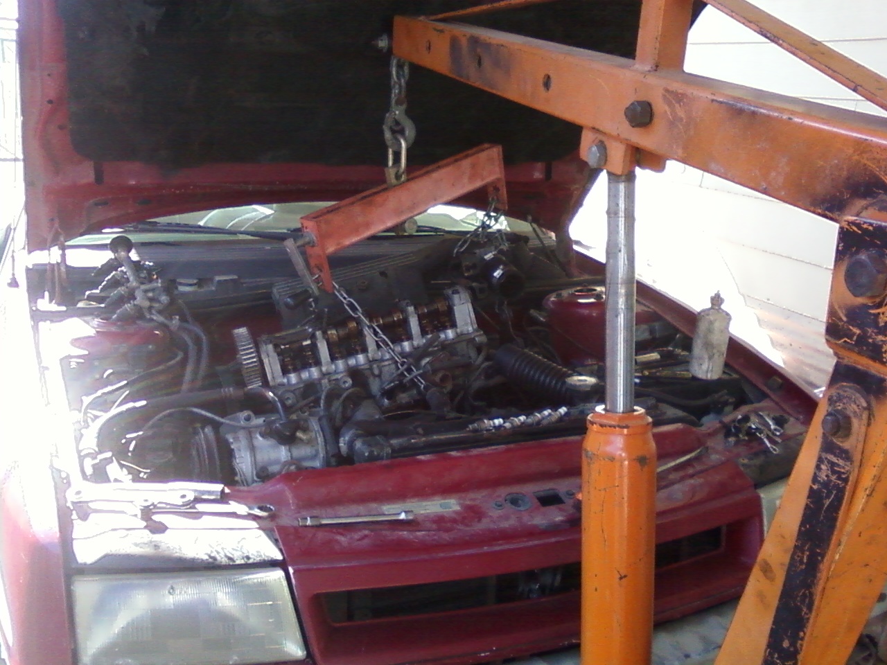

I put that cylinder head/VNT/Headgasket onto that block and I witness this car doing 13's. :)
Here are some pictures...
badly overheated head. It was NASTY!!
New used rebuilt head prepped and ready.

I'd post those emails up too! We'd probably get a good chuckle out of it. Dang was that head a little crispy looking!
