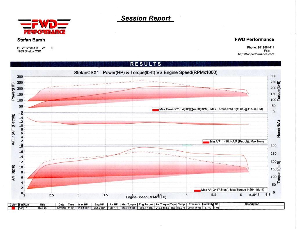

Did some more tinkering best dyno pull to date, pulled a little fuel out. Made 4 runs, all produced the same #'s. This will be all for this car for a while, as I am out of time and need to focus on other projects.
Boost spike to 17 psi then settles in around 15 psi.
218.4whp 264.1wtrq
251.2flyhp 303.7flytrq
