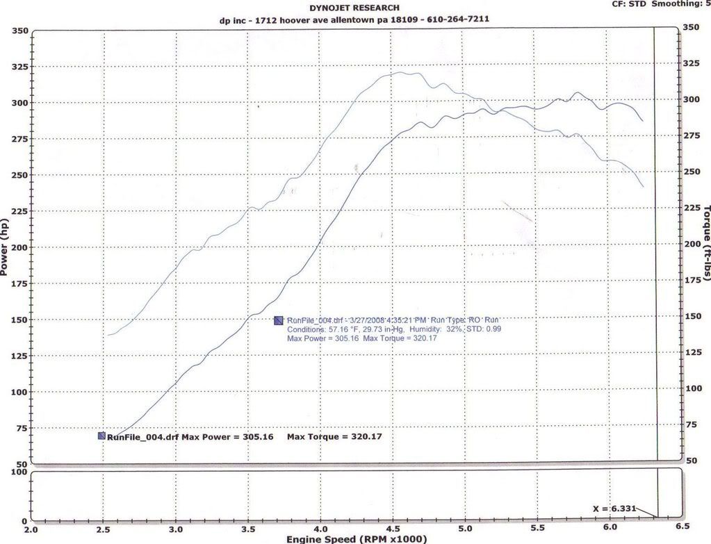

i finally got the spirit back together with the 57trim on and switched from a stage 1 fwd cal to a stage 4. car drives real nice and smooth and the power is definately there at the hit of the throttle. i'm quite impressed and can't wait til i get the new revised stage 4 chip from cindy. it made 305hp/320tq at 22psi with a/f in the mid 11's. we were going to raise the boost a bit more but nobody had race gas and i didn't want to push it.

I asked about the boost as the torque curve on your dyno plot drops off faster than it should after reaching its peak. If you correct this issue, your peak power reading will obviously skyrocket. At 22 psi boost, whp will likely be north of 350.

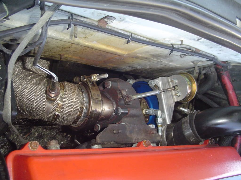

i'll have to look into that. the boost never drops below 22psi but the more i watch the boost gauge it seems to drop down to 22 even if i turn the boost controller up. when i bought the turbo he said it was a 57 but i just stuck my head under the hood after reading your post and saw that the compressor housing does indeed have a 50 on it. i can't believe i never noticed that. how would i go about correcting the issue of the curves falling off quickly?
Thats does not mean its a 50trim, thats the A/R of the Compressor housing, many hybrids use the same housings, its the wheel inside that denotes the trim. Which if I'm not mistaken makes it a B housing which makes the turbo a "half assed hybrid" because it doesn't use the native E compressor which is .60AR

The .50 on the compressor housing is more than likely the a/r ratio of the housing. NOT the trim of the compressor wheel itself. Which as you stated you were told is a 57 trim.

that makes sense. i never quite understood how to read the housing numbers.

I would be willing to be that you have the typical 50 trim hybrid. If it is a turbonetics, they are market right on the exhaust housing where the wg bolts up. Mine actually said 57 in the part number on the box, but I was told that the exhaust side is a 57 trim, and the intake side is the 50 trim. Is this a turbonetics? Did it come from cindy originally?
