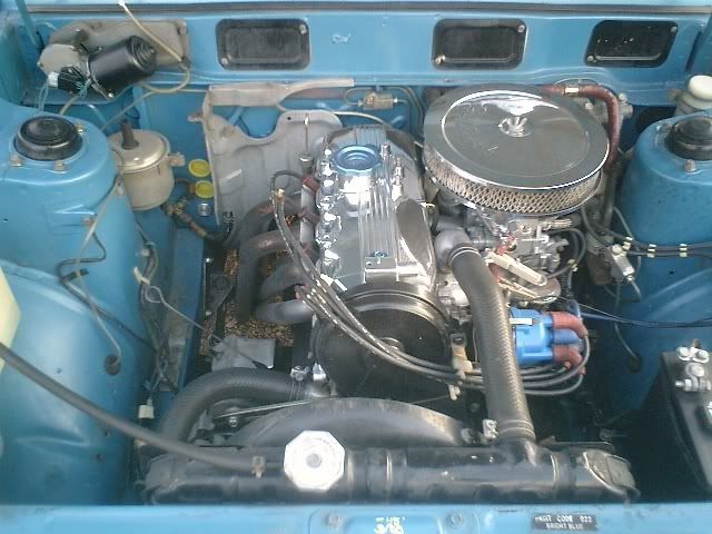

My friend finally gave up and sold me his 79 Colt, after bothering him for 3 years! I love driving this car but the engine has to go, it's a 1.6 with a 904 3 speed auto tranny. Am doing my homework to see what options are available.

Nice car, that is very mint. A 2.0 doc will fit nicely in there and you know what else can happen...
2,028 Posts
There is 4 or so turbo 4cyl colts running around. One guy has a Mitsubishi engine, a couple have a dodge 2.4DOHC turbo motors and 904/727 trans with an adapter(sold on here for $350), or you can use a Toyota supra manual trans w/ a 2.4(Liberty bellhousing modded) or 2.2/2.5SOHC motor(Dakota bellhousing). Another guy has a Hybrid motor(2.2 or 2.5 with a neon DOHC head) and 904 trans.
All of these guys have high HP setups, most of them know the 4cyl turbo motors very well and chose RWD for drag racing purposed
I would just keep the 904 and buy a adapter from turbocolt, and buy a 95-99 dodge stratus 2.4DOHC motor and get MegaSquirt to run it(neons.org has all the info you would ever need about MS). Then you can turbo it later easily if your into that and your budget will allow. It really depends on what tools you have and your ability to fabricate, if you have a welder many things are possible.
