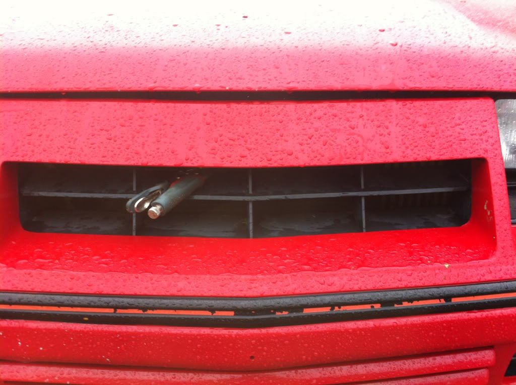

If you have ever broken your hood release cable or you hood no longer lifts out of the latch on its own I have the solution for you!!
If you stick you hand into the hole that the pliers are in the photo... PALM UP! in the front grill on your first gen Daytona with your left hand and find the first centre beam if you reach right behind it and up as high as you can you will feel a square thing thy seem out of place (size of scrabble peice) ad push it towards the drivers side of the car (your right) the hood will open... I have fairly large hands and can do it in under five seconds. I don't know if I could also do this on a 89 style front but it will be the same concept just getting your hand through the hole will be harder. And make sure your palm is face up or you'll hurt yourself :p

This trick probably wont work on any other year daytona except first gens, since the hood mechanism is different as well as covered by the nose. Also, 84-85 hoods have the latch positioned in a diffferent position than this one.
