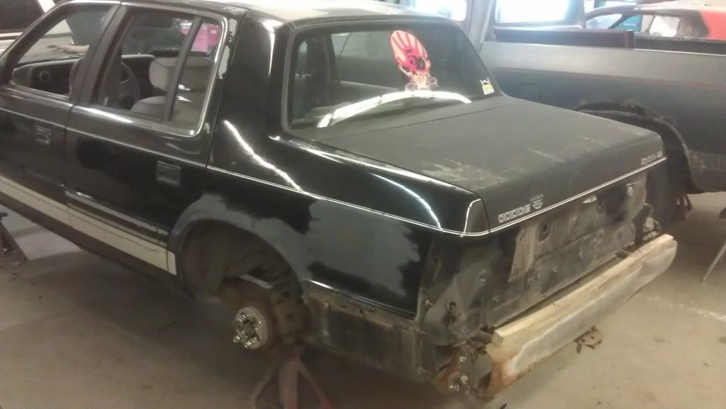

So I've done a lot of work on this car, my first real big project and I feel like posting photos and what-not up here to maybe get some C&C, maybe new ideas as well.
The first bunch of photos are from when I first got the car. Was bought from Moparnutz with no engine or trans installed, interior apart and all the pieces given to me. Converted it from auto to a 5-speed with the A-523 trans, replaced the 2.5L T1 that had blown originally after a cam cap popped off on the highway and it blew a hole through the block... still made it all the way home though ;).
I also threw a few more goodies on there, like a T03 with a larger compressor wheel, and intercooled it so it's almost a full T2 setup. Need ECU still.
While I was driving the car, before I went into school for automotive collision repair the motor had more issues [was a random wrecker 2.5] and it needed to be replaced, the block anyways, so I took it out while at school... I didn't plan on it but I got bored one afternoon and took advantage of the air tools! One of the rockers also popped off, oddly enough.
Enjoy the ass load of photos and feel free to give any C&C!
There's a lot more pictures on Facebook, so I tried to only pic ones to show the progress well.
I'd also like to note, I've never done any custom work to any car before... as in drilling, welding or cutting.

Thought I'd throw this up here. Before we brought the cars in we practised MIG welding and welding/brazing/cutting with the oxy/acedelyne torch. We got bored with the oxy quick and Moparnutz drew me out a stencil to cut!
Now the car is in the shop

Had to remake almost every bracket for the bumpers and ground effects.
Classic rusted through floor @ ebrake

That's it up to the current date 15/06/2012.
I'm currently working on installed my nicer boost gauge and a/f gauge into the dash. I've got about a week to kill before we prime any cars and I've got nothing to do... so why not get the interior going nicely!
I'm also working on the hood for my Daytona IROC, so the hood will close with the larger intake manifold for anyone who has seen it before.
