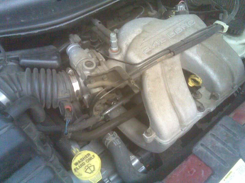

hey, i don't know if any one has seen one because these are a rare duck
but a late model caravan lower intake may look like a good choice for some of ya'll. like the way the water neck is if your staying with your stock radiator.
this one is a 2005 model
139 Posts
I would love to have one of those for my 2.4 minivan for when I switch to a PT head. Having the TB on the passenger side would allow me to have a much better intake. The PT intake I have looks like it might hit my wiper motor.
86 Posts
If you are going to use this intake plan on doin some drilling, I got one from a 96 caravan and had to drill it so it would bolt to my 99 2.4 head. I did not use the plenum i cut it short and used 5'' pipe
