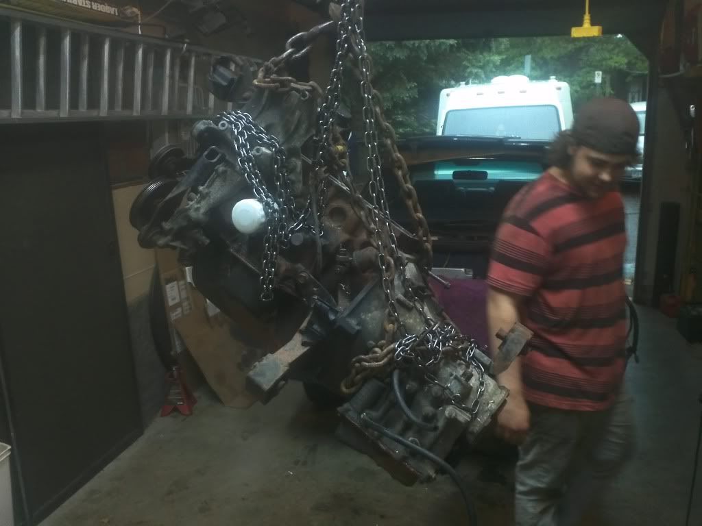

just got done taking the motor and trans out of my car and couldn't break lose the stupid feed line on the power steeing pump(the high pressure one). I was getting mad and after rounding it to death and got out the hack saw.... Where can i get a new one? or do I need to make something? just the feed line
everything went real smooth other than that!
went and got a Block and Tackle today and it worked awesome, I like it way better than a hoist
