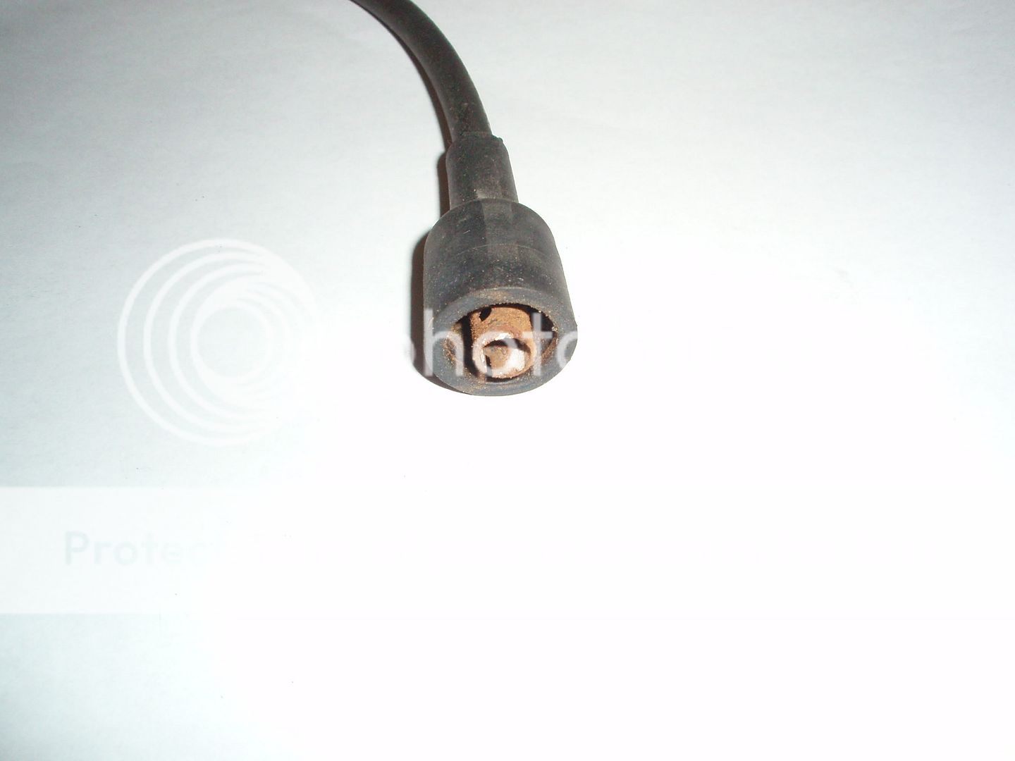

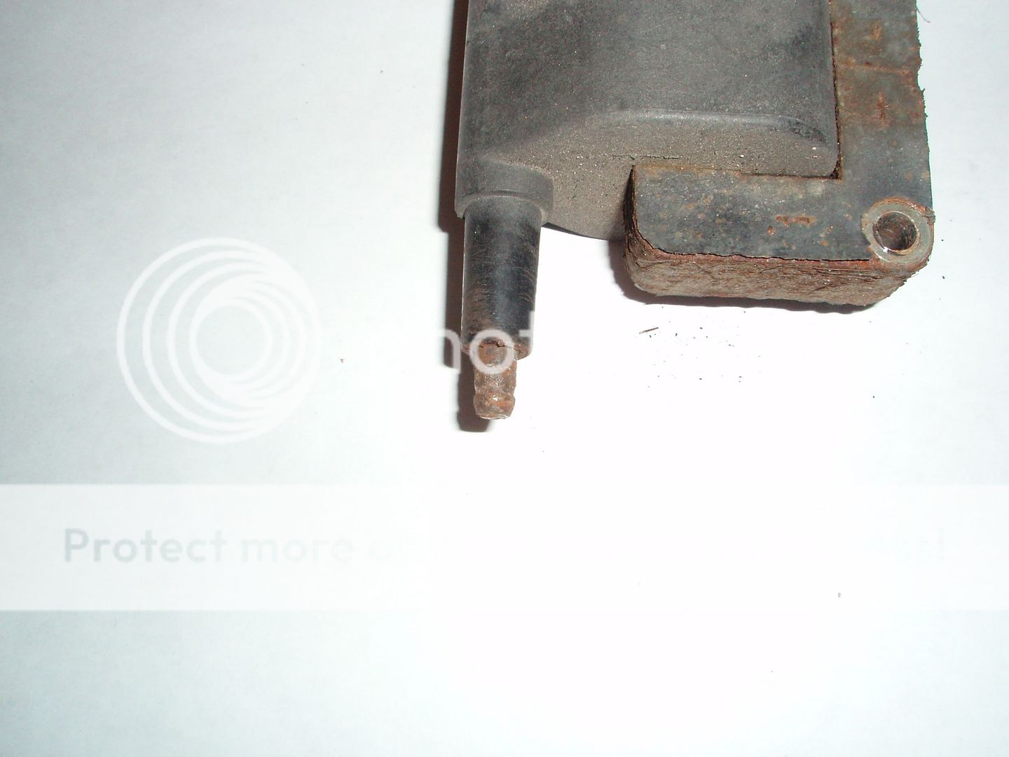

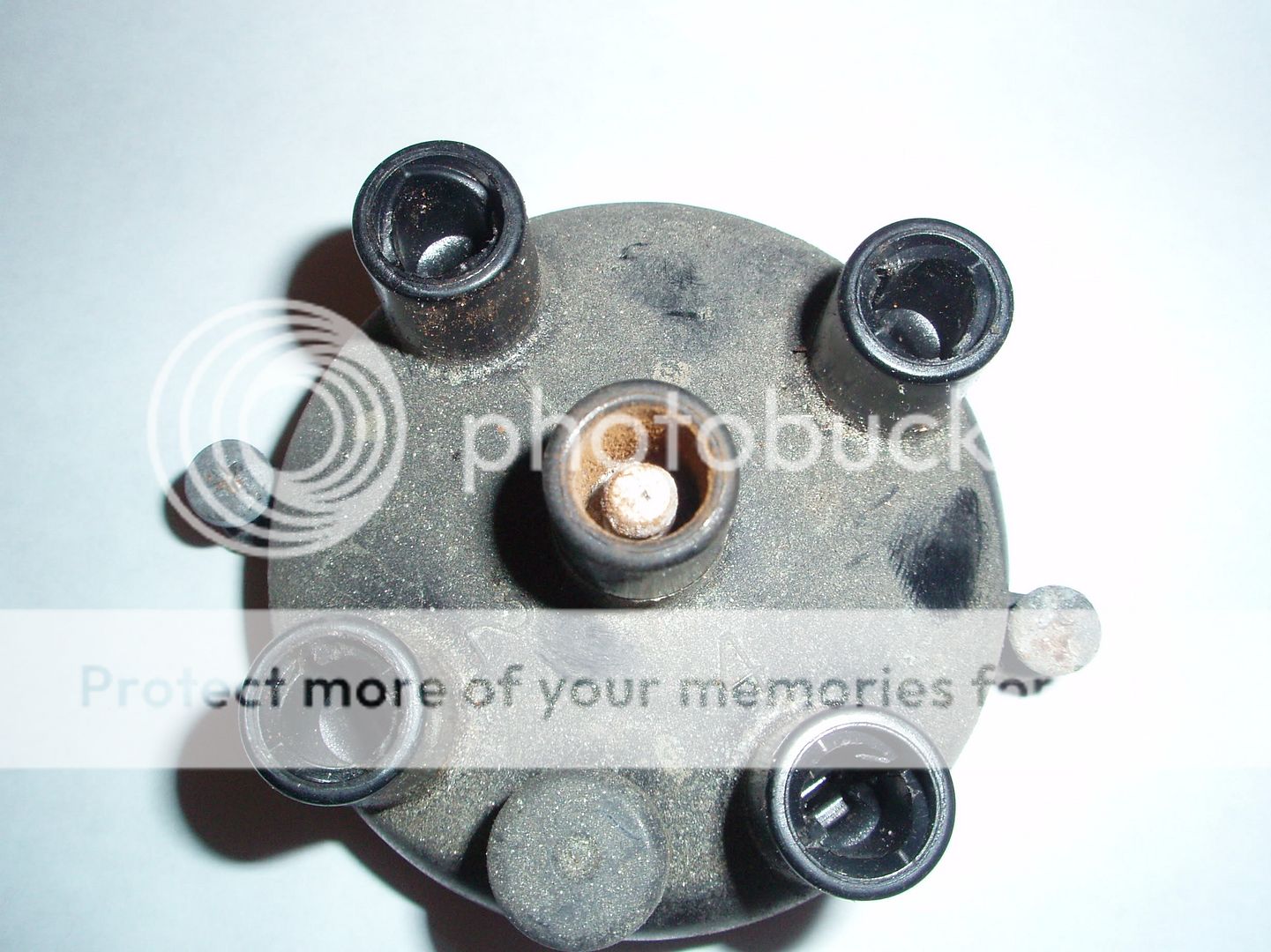

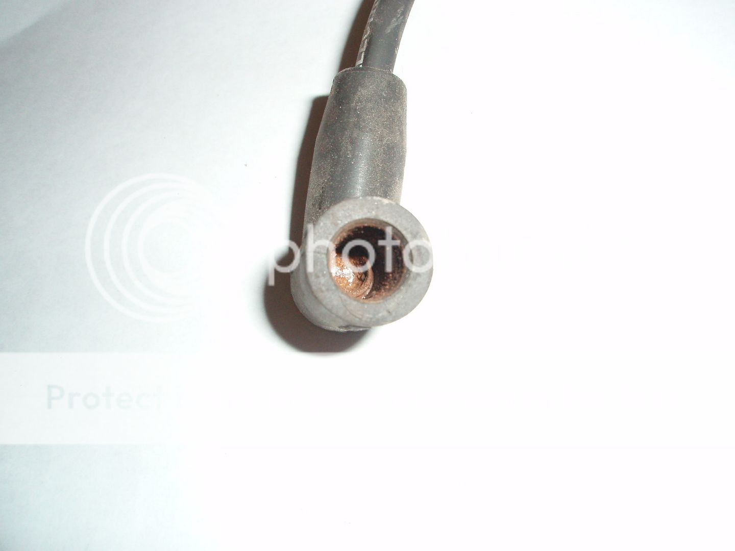

Car was running fine, haven't driven in probably a year, started it up a bunch of time just to keep everything lubed. Had to take it to get inspected, so I've been driving it ever since just to give it some exercise, figured I'd do a little tune up, look what I found....
I know the aftermarket coils don't offer much in terms of improved performance, but they do seem to be made with some better materials, you don't get that kind of corrosion with brass terminals.

your supposed to grease those ends though, water doesn't get in there that way. Also a cheap wire made of steel will rust and corode anything it touches. Not really an excuse but by the look of the cap and the rust on the aluminum contact I'd say the wire was the biggest problem.

Had to get it inspected so I've been driving it for about 2 weeks now, never did any work to it. Figured I might as well do a basic tune up on it so it got new plugs, wires, rotor, coil and the cap from one of the other cars after I washed it clean, was like new. Oh and I did grease all the towers on the cap and on the coil.

don't grease all the towers lol, just the middle one
